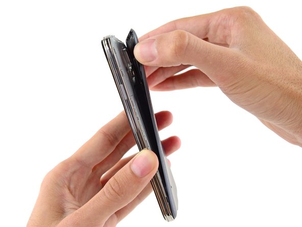

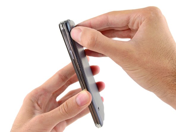

    • Insert a fingernail or plastic opening tool into the divot to the left of the rear-facing camera.
    • Gently pry and twist the flexible rear cover off the back of the phone.

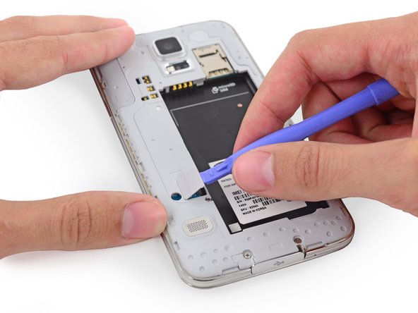

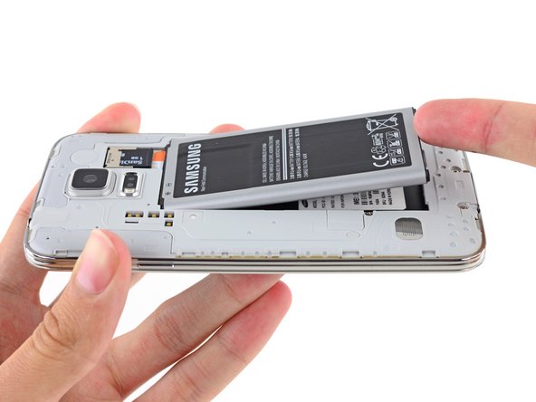

  2. Samsung Galaxy S5 Display Assembly Replacement: step 2, image 1 of 3 Samsung Galaxy S5 Display Assembly Replacement: step 2, image 2 of 3 Samsung Galaxy S5 Display Assembly Replacement: step 2, image 3 of 3

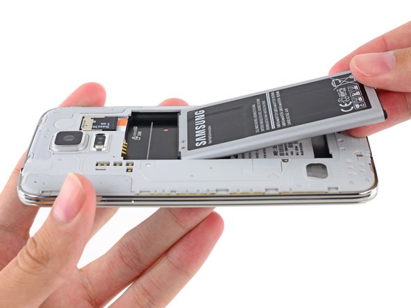

    • Insert a fingernail or plastic opening tool into the recess in the bottom right corner of the battery and lift upward.
    • Remove the battery away from the phone.

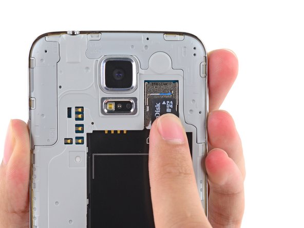

    • Using a fingertip, pull the microSD card straight down out of its slot.
    • Remove the microSD card from the phone.

  5. Samsung Galaxy S5 Display Assembly Replacement: step 5, image 1 of 3 Samsung Galaxy S5 Display Assembly Replacement: step 5, image 2 of 3 Samsung Galaxy S5 Display Assembly Replacement: step 5, image 3 of 3

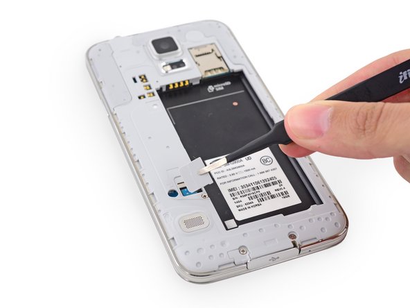

    • Use a plastic opening tool to pry up the plastic midframe connector panel.
    • Remove the connector panel with a pair of tweezers.
    • There should be enough adhesive to readhere the panel upon reassembly, otherwise use a small amount of double-stick tape.

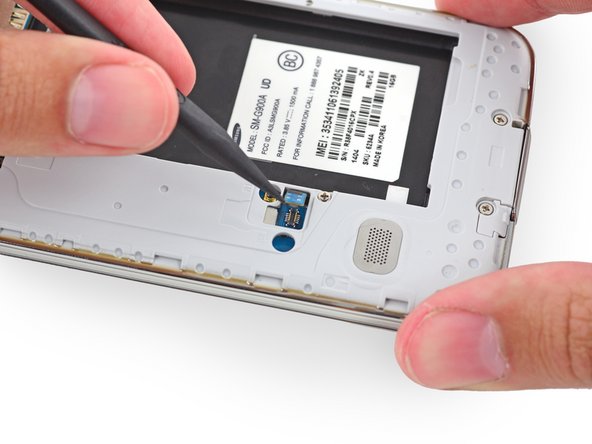

  6. Samsung Galaxy S5 Display Assembly Replacement: step 6, image 1 of 2 Samsung Galaxy S5 Display Assembly Replacement: step 6, image 2 of 2
    • Use the sharp tip of a spudger to pry the home button cable connector straight up off its socket.

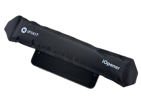

    • In the following steps you will be using an iOpener to warm the adhesive affixing the display assembly to the rest of the phone. This will allow for a safer, easier screen removal. For proper iOpener use, follow our [invalid guide link], make sure to pay attention to all warnings.
    • Place a heated iOpener on the left side of the phone for at least 90 seconds.
    • Reheat the iOpener and place it on the right half of the phone.

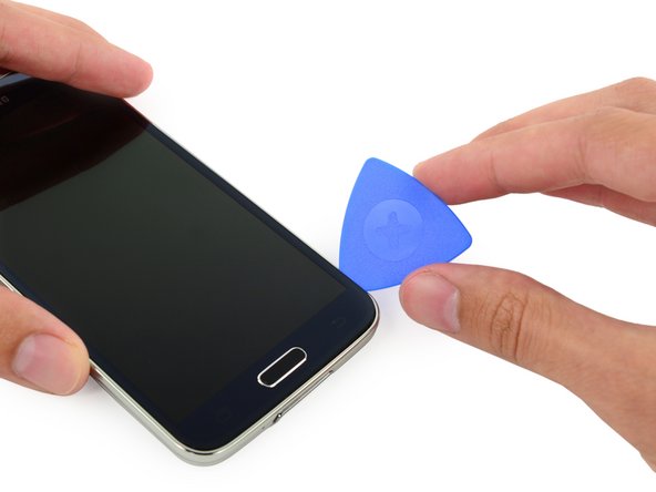

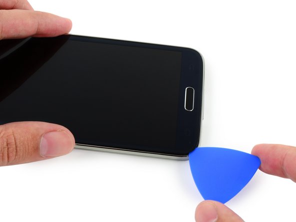

  8. Samsung Galaxy S5 Display Assembly Replacement: step 8, image 1 of 2 Samsung Galaxy S5 Display Assembly Replacement: step 8, image 2 of 2

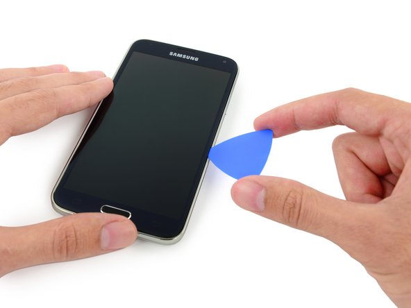

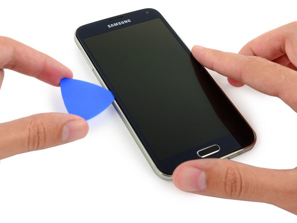

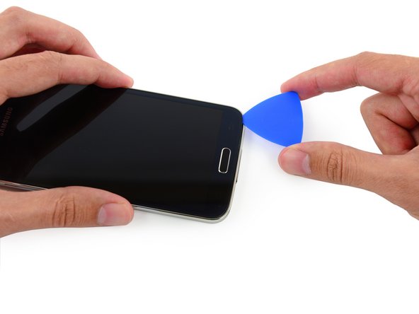

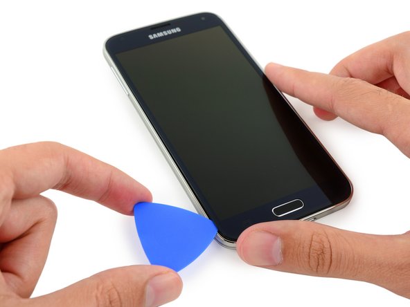

    • In the following steps you will be using an opening pick to separate the adhesive securing the front panel glass. Only pry where directed. If you experience resistance, stop sliding the opening pick and reapply heat.
    • Insert the edge of an opening pick underneath the bottom right side of the front glass.

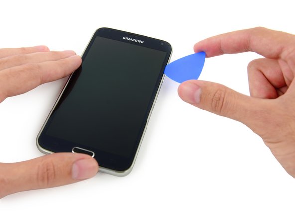

  9. Samsung Galaxy S5 Display Assembly Replacement: step 9, image 1 of 3 Samsung Galaxy S5 Display Assembly Replacement: step 9, image 2 of 3 Samsung Galaxy S5 Display Assembly Replacement: step 9, image 3 of 3
    • Slide the opening pick up along the right side of the display.

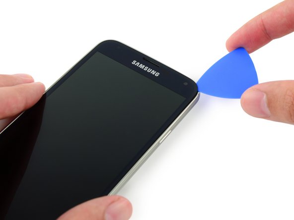

  10. Samsung Galaxy S5 Display Assembly Replacement: step 10, image 1 of 3 Samsung Galaxy S5 Display Assembly Replacement: step 10, image 2 of 3 Samsung Galaxy S5 Display Assembly Replacement: step 10, image 3 of 3

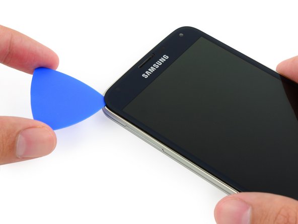

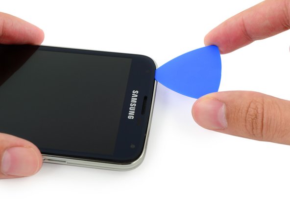

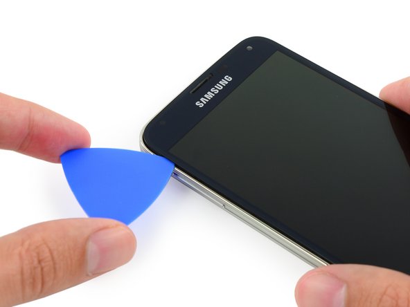

    • Carefully slide the pick around the corner, stopping before the speaker grille at the top of the phone.
  11. Samsung Galaxy S5 Display Assembly Replacement: step 11, image 1 of 3 Samsung Galaxy S5 Display Assembly Replacement: step 11, image 2 of 3 Samsung Galaxy S5 Display Assembly Replacement: step 11, image 3 of 3

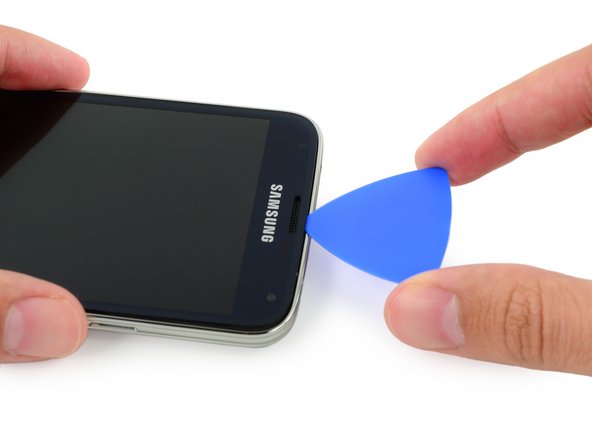

    • The adhesive securing the top of the phone is only a narrow strip above the earpiece speaker. Slide the pick along the top of the speaker to avoid damaging internal components.
    • Slide the opening pick across the top of the phone, being very careful not to insert the pick too deeply.

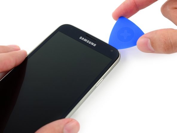

    • Carefully slide the pick around the upper left corner.
    • If you encounter any resistance from cooling adhesive, reapply a heated iOpener to the left side of the phone.

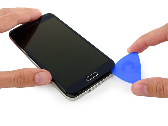

  15. Samsung Galaxy S5 Display Assembly Replacement: step 15, image 1 of 1
    • Place a reheated iOpener over the bottom portion of the display assembly.
    • There are delicate components in this portion of the phone, you want to ensure the adhesive is warm and easy to loosen to protect the phone.

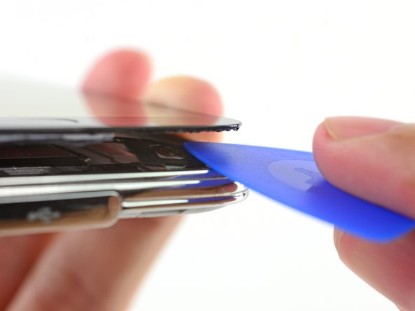

  16. Samsung Galaxy S5 Display Assembly Replacement: step 16, image 1 of 3 Samsung Galaxy S5 Display Assembly Replacement: step 16, image 2 of 3 Samsung Galaxy S5 Display Assembly Replacement: step 16, image 3 of 3

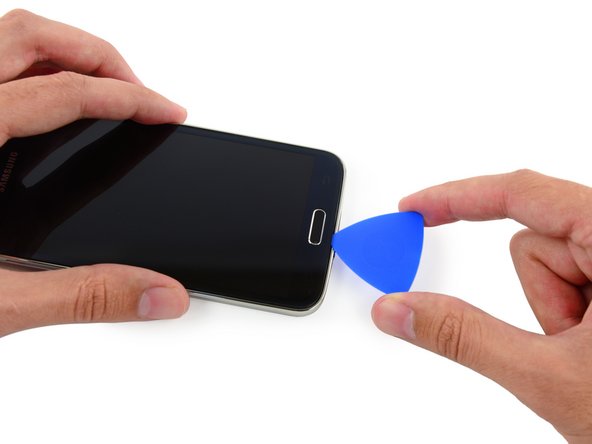

    • The bottom end of the phone contains the soft button and home button ribbon cables. If you insert the opening pick too far into the phone you risk cutting these cables.
    • Slide the very end of the opening pick across the bottom edge of the display to separate the last of the remaining adhesive.
  17. Samsung Galaxy S5 Display Assembly Replacement: step 17, image 1 of 2 Samsung Galaxy S5 Display Assembly Replacement: step 17, image 2 of 2
    • Twist the opening pick to detach the glass from the phone.
    • If the front panel does not detach easily, it may require additional adhesive cutting.

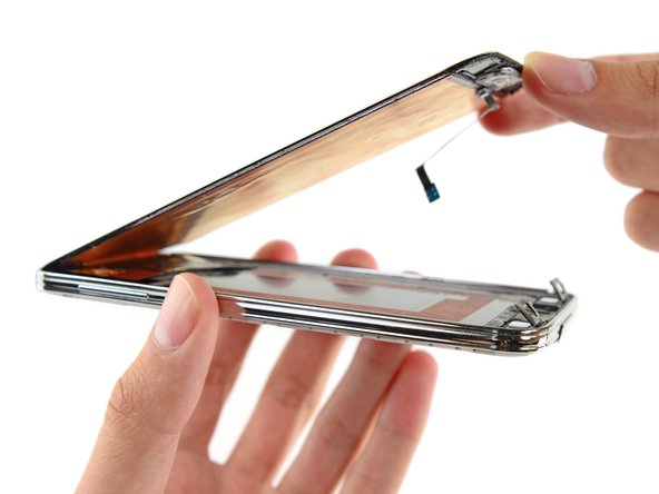

  19. Samsung Galaxy S5 Display Assembly Replacement: step 19, image 1 of 2 Samsung Galaxy S5 Display Assembly Replacement: step 19, image 2 of 2

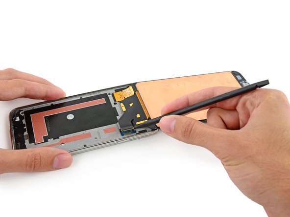

    • Slightly lift, but do not remove, the home button end of display assembly.
    • Do not remove the front panel entirely. It is still attached by a connector.
    • If you are reusing the home button flex cable, be careful not to sever the cable from the home button. Adhesive can cause the cable to rip apart from the home button. While the home button will still work, the fingerprint scanner will not.

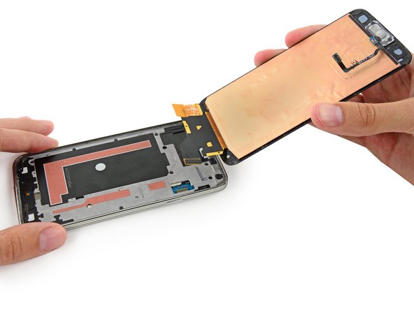

  20. Samsung Galaxy S5 Display Assembly Replacement: step 20, image 1 of 3 Samsung Galaxy S5 Display Assembly Replacement: step 20, image 2 of 3 Samsung Galaxy S5 Display Assembly Replacement: step 20, image 3 of 3
    • Use the sharp tip of a spudger to lift the front panel assembly cable connector straight up off its socket on the motherboard.
    • Safely remove the front panel assembly from phone.
