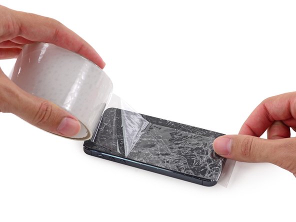

    1. iPhone 5 Display Assembly Replacement, Display Assembly: step 1, image 1 of 3 iPhone 5 Display Assembly Replacement, Display Assembly: step 1, image 2 of 3 iPhone 5 Display Assembly Replacement, Display Assembly: step 1, image 3 of 3
      • If your display glass is cracked, keep further breakage contained and prevent bodily harm during your repair by taping the glass.
      • Lay overlapping strips of clear packing tape over the iPhone's display until the whole face is covered.
      • This will keep glass shards contained and provide structural integrity when prying and lifting the display.
      • Wear safety glasses to protect your eyes from any glass shaken free during the repair.

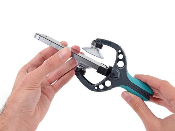

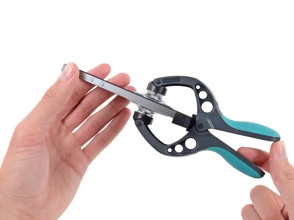

    4. iPhone 5 Display Assembly Replacement, iSclack Opening Procedure: step 4, image 1 of 3 iPhone 5 Display Assembly Replacement, iSclack Opening Procedure: step 4, image 2 of 3 iPhone 5 Display Assembly Replacement, iSclack Opening Procedure: step 4, image 3 of 3
      • The next two steps demonstrate using the , a great tool for safely opening the iPhone 5 that we recommend for anyone doing more than one repair. If you aren't using the iSclack, skip to Step 6.
      • Close the handle on the iSclack, opening the suction-cup jaws.
      • Place the bottom of your iPhone in between the suction cups, against the plastic depth gauge.
      • The top suction cup should rest just above the home button.
      • Open the handles to close the jaws of the iSclack. Center the suction cups and press them firmly onto the top and bottom of the iPhone.

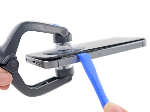

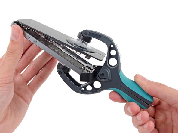

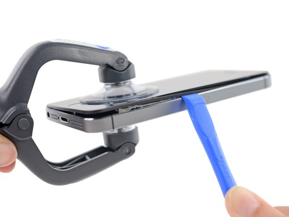

    5. iPhone 5 Display Assembly Replacement: step 5, image 1 of 2 iPhone 5 Display Assembly Replacement: step 5, image 2 of 2
      • Hold onto your iPhone securely and close the handle of the iSclack to separate the suction cups, pulling the front panel up from the rear case.
      • The iSclack is designed to safely open your iPhone just enough to separate the pieces, but not enough to damage any cables.
      • Peel the two suction cups off your iPhone.
      • Skip the next three steps and continue on Step 9.

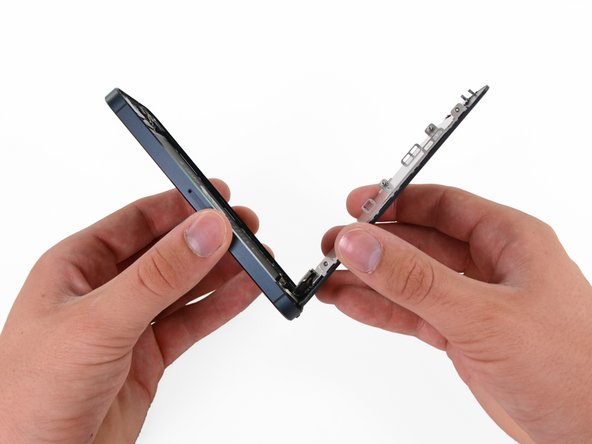

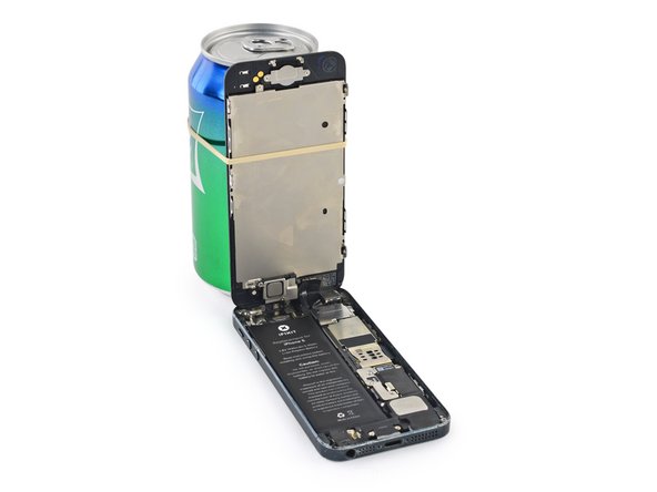

    9. iPhone 5 Display Assembly Replacement: step 9, image 1 of 3 iPhone 5 Display Assembly Replacement: step 9, image 2 of 3 iPhone 5 Display Assembly Replacement: step 9, image 3 of 3
      • Do not try to completely remove the front panel assembly from the rear case, as there are several ribbon cables still attached at the top of the iPhone.
      • Once the clips have been released on the bottom and sides of the front panel assembly, pull the bottom of the assembly away from the rear case.
      • Open the display to about a 90º angle, and lean it against something to keep it propped up while you're working on the phone.
      • Add a rubber band to keep the display securely in place while you work. This prevents undue strain on the display cables.

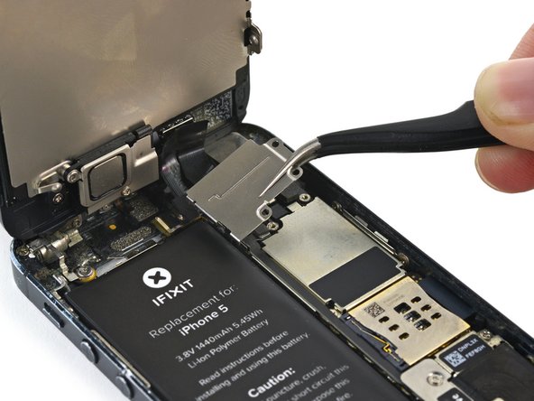

    14. iPhone 5 Display Assembly Replacement: step 14, image 1 of 2 iPhone 5 Display Assembly Replacement: step 14, image 2 of 2
      • Lift the display cable bracket toward the battery to unhook it, and remove it from the iPhone.
      • During reassembly, clip the left-hand hooks under the logic board and lower the bracket towards the outside of the phone.

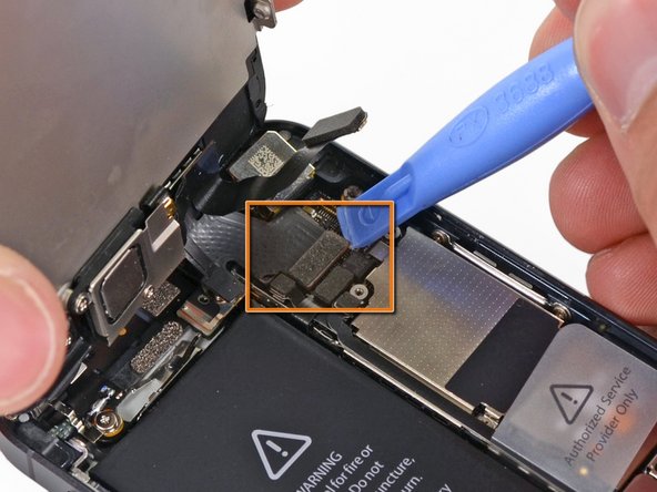

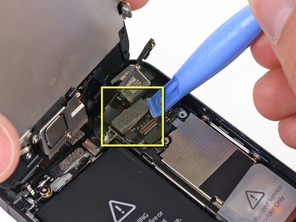

    15. iPhone 5 Display Assembly Replacement: step 15, image 1 of 3 iPhone 5 Display Assembly Replacement: step 15, image 2 of 3 iPhone 5 Display Assembly Replacement: step 15, image 3 of 3
      • Use a plastic opening tool to disconnect the three front panel assembly cables:
      • Front-facing camera and sensor cable
      • LCD cable
      • Digitizer cable
      • When reassembling your phone, the LCD cable may pop off the connector. This can cause white lines, or nothing at all to appear when powering your phone back on. If that happens, simply reconnect the cable and power cycle your phone. The best way to power cycle your phone is to disconnect and reconnect the battery.
