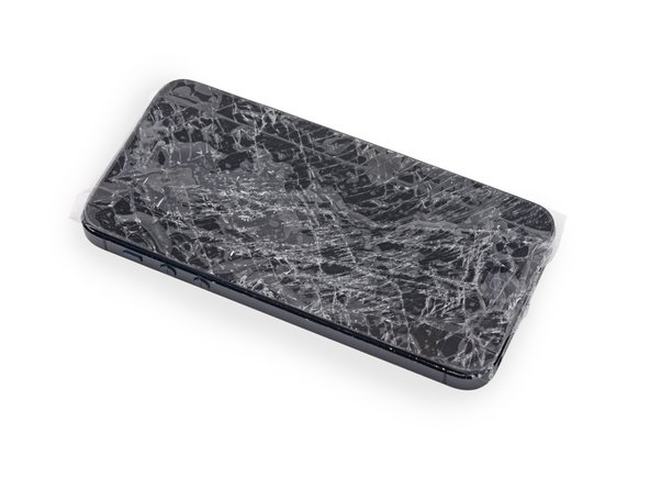

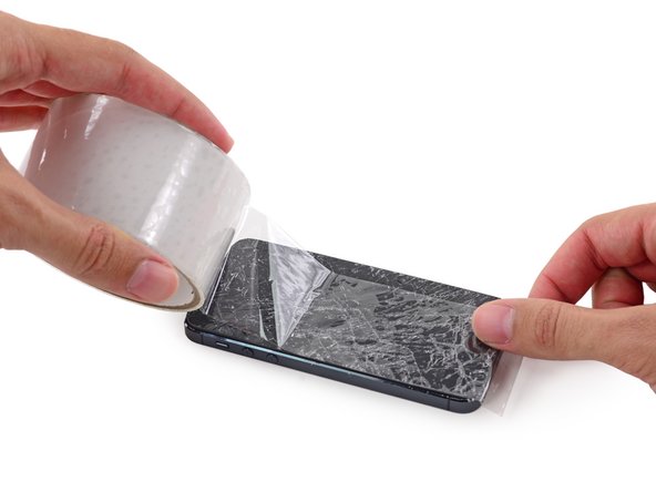

      • If your display glass is cracked, keep further breakage contained and prevent bodily harm during your repair by taping the glass.
      • Lay overlapping strips of clear packing tape over the iPhone's display until the whole face is covered.
      • This will keep glass shards contained and provide structural integrity when prying and lifting the display.
      • Wear safety glasses to protect your eyes from any glass shaken free during the repair.

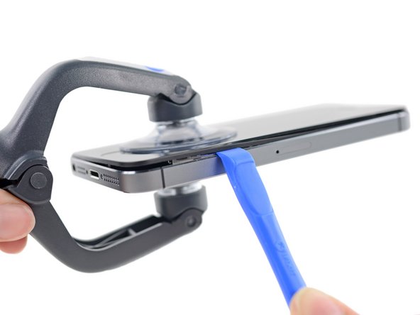

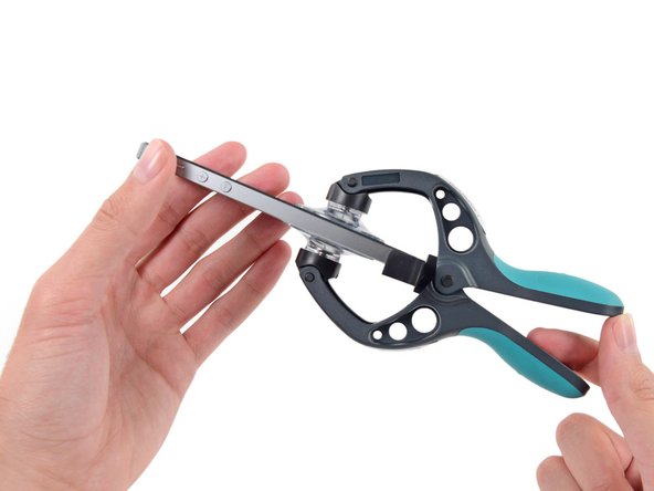

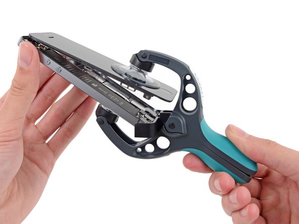

    4. iPhone 5 Front Panel Clips Replacement, iSclack Opening Procedure: step 4, image 1 of 3 iPhone 5 Front Panel Clips Replacement, iSclack Opening Procedure: step 4, image 2 of 3 iPhone 5 Front Panel Clips Replacement, iSclack Opening Procedure: step 4, image 3 of 3
      • The next two steps demonstrate using the , a great tool for safely opening the iPhone 5 that we recommend for anyone doing more than one repair. If you aren't using the iSclack, skip to Step 6.
      • Close the handle on the iSclack, opening the suction-cup jaws.
      • Place the bottom of your iPhone in between the suction cups, against the plastic depth gauge.
      • The top suction cup should rest just above the home button.
      • Open the handles to close the jaws of the iSclack. Center the suction cups and press them firmly onto the top and bottom of the iPhone.

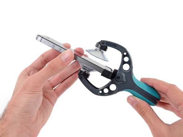

    5. iPhone 5 Front Panel Clips Replacement: step 5, image 1 of 2 iPhone 5 Front Panel Clips Replacement: step 5, image 2 of 2
      • Hold onto your iPhone securely and close the handle of the iSclack to separate the suction cups, pulling the front panel up from the rear case.
      • The iSclack is designed to safely open your iPhone just enough to separate the pieces, but not enough to damage any cables.
      • Peel the two suction cups off your iPhone.
      • Skip the next three steps and continue on Step 9.

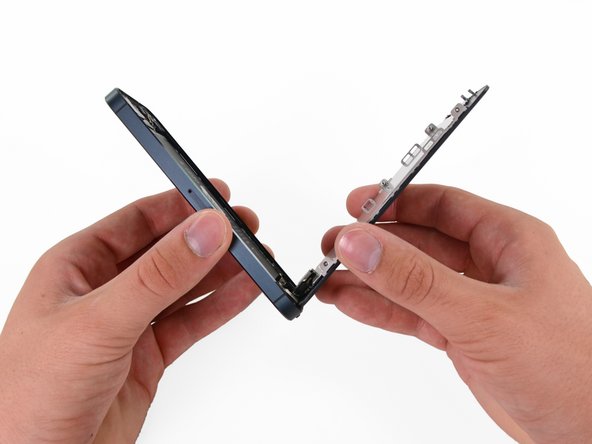

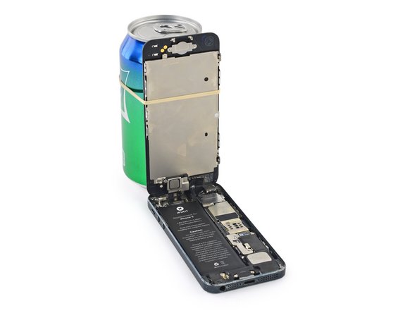

    9. iPhone 5 Front Panel Clips Replacement: step 9, image 1 of 3 iPhone 5 Front Panel Clips Replacement: step 9, image 2 of 3 iPhone 5 Front Panel Clips Replacement: step 9, image 3 of 3
      • Do not try to completely remove the front panel assembly from the rear case, as there are several ribbon cables still attached at the top of the iPhone.
      • Once the clips have been released on the bottom and sides of the front panel assembly, pull the bottom of the assembly away from the rear case.
      • Open the display to about a 90º angle, and lean it against something to keep it propped up while you're working on the phone.
      • Add a rubber band to keep the display securely in place while you work. This prevents undue strain on the display cables.

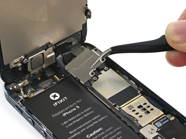

      • Lift the display cable bracket toward the battery to unhook it, and remove it from the iPhone.
      • During reassembly, clip the left-hand hooks under the logic board and lower the bracket towards the outside of the phone.

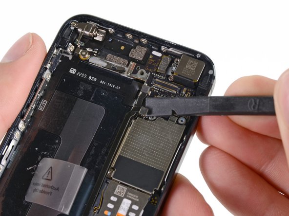

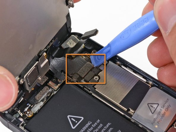

    15. iPhone 5 Front Panel Clips Replacement: step 15, image 1 of 3 iPhone 5 Front Panel Clips Replacement: step 15, image 2 of 3 iPhone 5 Front Panel Clips Replacement: step 15, image 3 of 3
      • Use a plastic opening tool to disconnect the three front panel assembly cables:
      • Front-facing camera and sensor cable
      • LCD cable
      • Digitizer cable
      • When reassembling your phone, the LCD cable may pop off the connector. This can cause white lines, or nothing at all to appear when powering your phone back on. If that happens, simply reconnect the cable and power cycle your phone. The best way to power cycle your phone is to disconnect and reconnect the battery.

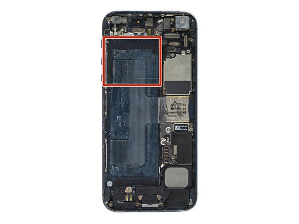

    18. iPhone 5 Front Panel Clips Replacement: step 18, image 1 of 1
      • If the tab breaks off and the battery remains stuck to the rear case, prepare an iOpener or use a hair dryer to heat the rear case directly behind the battery.
      • This will soften the adhesive holding the battery, making it easier and safer to pry out of the case.
    19. iPhone 5 Front Panel Clips Replacement: step 19, image 1 of 2 iPhone 5 Front Panel Clips Replacement: step 19, image 2 of 2
      • Use the plastic opening tool to gently pry the battery up, only at the outside edge of the phone. Prying anywhere else, especially near the logic board, may result in damage to the logic board.
      • If the battery doesn't pry easily out of the case, reheat and reapply the iOpener and try again.
      • Pry gently and evenly to avoid deforming the battery. A bent battery can be a fire hazard.
      • Do not pry at the top portion of the battery, you risk severing the volume control cables.

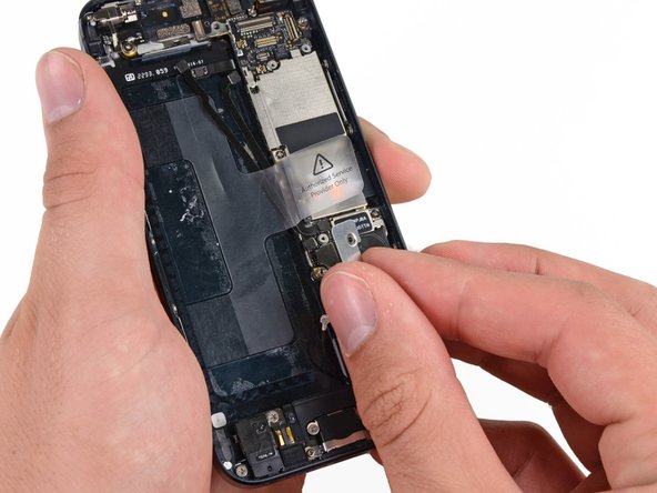

      • Use the tip of a spudger to pry the cellular data antenna cable connector up from its socket on the logic board, just above the speaker enclosure.
    22. iPhone 5 Front Panel Clips Replacement: step 22, image 1 of 1

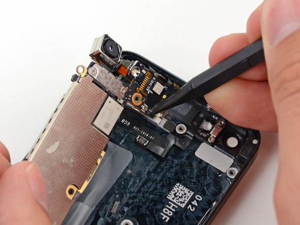

    24. iPhone 5 Front Panel Clips Replacement: step 24, image 1 of 3 iPhone 5 Front Panel Clips Replacement: step 24, image 2 of 3 iPhone 5 Front Panel Clips Replacement: step 24, image 3 of 3

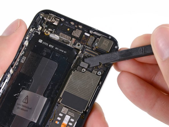

      • Use the flat end of a spudger to disconnect the following three cables from the logic board:
      • Upper interconnect cable
      • Button assembly cable
      • Lower interconnect cable

      • Use a spudger to pry the Lightning connector cable connector up from its socket on the logic board.
      • Gently peel the cable back and out of the way of the logic board.

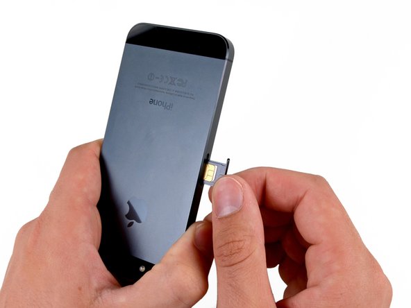

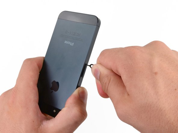

    29. iPhone 5 Front Panel Clips Replacement: step 29, image 1 of 3 iPhone 5 Front Panel Clips Replacement: step 29, image 2 of 3 iPhone 5 Front Panel Clips Replacement: step 29, image 3 of 3
      • Depress the SIM card release on the right side of the iPhone with a SIM card eject tool or a bent paperclip to eject the SIM card tray.
      • Alternatively, you can press the SIM card eject lever from the inside with the flat end of a spudger.
      • Remove the SIM card tray from the iPhone.

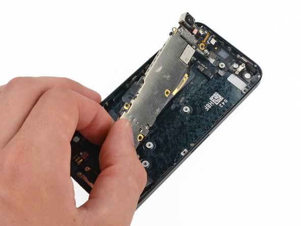

      • Rotate the logic board assembly toward the battery side of the rear case.
      • Do not attempt to completely remove the logic board assembly from the rear case, yet; there is still one cable connected to the underside of the logic board.
      • The flash surround is adhered to the flash unit and the rear case. If it stays on the rear case remove with tweezers and mount it back on the flash unit.
      • Note: when reassembling your device, be sure that the lower interconnect cable is not tucked underneath the logic board.

      • Remove the logic board assembly from the rear case.
      • While your logic board is out of your phone, keep it on a grounded anti-static mat to prevent any damage to the circuitry.

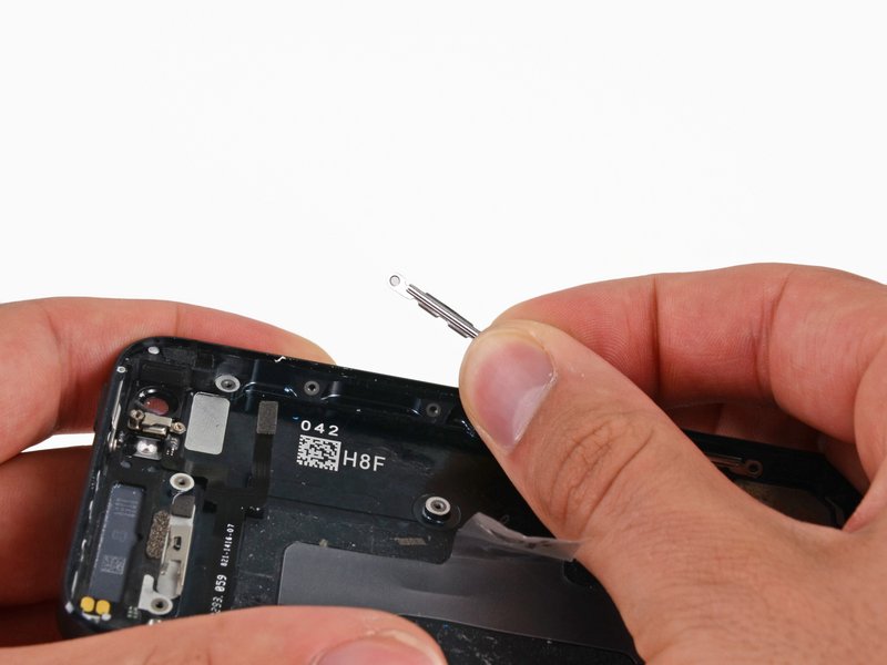

    34. iPhone 5 Front Panel Clips Replacement: step 34, image 1 of 2 iPhone 5 Front Panel Clips Replacement: step 34, image 2 of 2

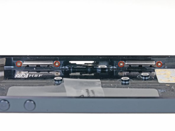

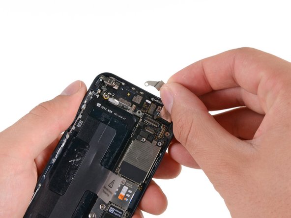

      • The four front panel clips are held in with two 1.3 mm Phillips screws each. Remove the screws on the clip(s) you want to replace.
    35. iPhone 5 Front Panel Clips Replacement: step 35, image 1 of 1
      • Remove each clip, as needed.
      • Note that the top clip on the left side of the device is smaller than the other three.
