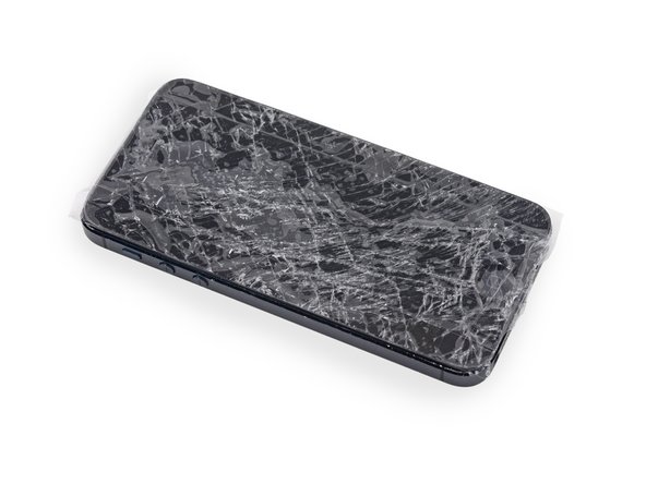

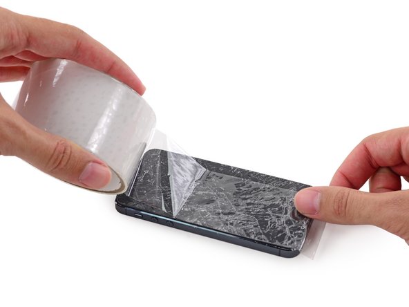

    • If your display glass is cracked, keep further breakage contained and prevent bodily harm during your repair by taping the glass.
    • Lay overlapping strips of clear packing tape over the iPhone's display until the whole face is covered.
    • This will keep glass shards contained and provide structural integrity when prying and lifting the display.
    • Wear safety glasses to protect your eyes from any glass shaken free during the repair.

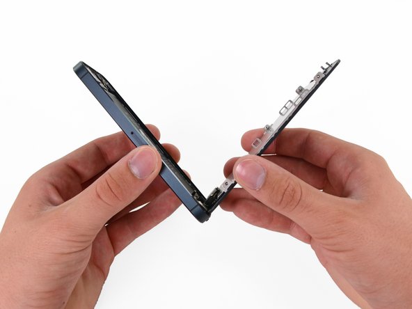

  3. iPhone 5 Front-Facing Camera and Sensor Cable Replacement: step 3, image 1 of 3 iPhone 5 Front-Facing Camera and Sensor Cable Replacement: step 3, image 2 of 3 iPhone 5 Front-Facing Camera and Sensor Cable Replacement: step 3, image 3 of 3
    • In the following steps you will be pulling the display up out of the phone body. The display is composed of a glass screen and a plastic bezel with metal clips.
    • Regardless of the tool you use, you need to be sure you pull up the entire display.
    • If the glass begins to separate from the plastic, as shown in the first image, slide a plastic opening tool between the plastic frame and the metal phone body to pry the metal clips out of the case.
    • If you are reassembling a phone with a separated display bezel, you may want to place a thin strip of adhesive between the plastic bezel and the glass to keep the phone closed.

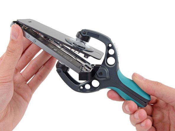

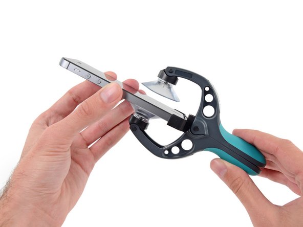

  4. iPhone 5 Front-Facing Camera and Sensor Cable Replacement, iSclack Opening Procedure: step 4, image 1 of 3 iPhone 5 Front-Facing Camera and Sensor Cable Replacement, iSclack Opening Procedure: step 4, image 2 of 3 iPhone 5 Front-Facing Camera and Sensor Cable Replacement, iSclack Opening Procedure: step 4, image 3 of 3
    • The next two steps demonstrate using the , a great tool for safely opening the iPhone 5 that we recommend for anyone doing more than one repair. If you aren't using the iSclack, skip to [invalid guide link].
    • Close the handle on the iSclack, opening the suction-cup jaws.
    • Place the bottom of your iPhone in between the suction cups, against the plastic depth gauge.
    • The top suction cup should rest just above the home button.
    • Open the handles to close the jaws of the iSclack. Center the suction cups and press them firmly onto the top and bottom of the iPhone.

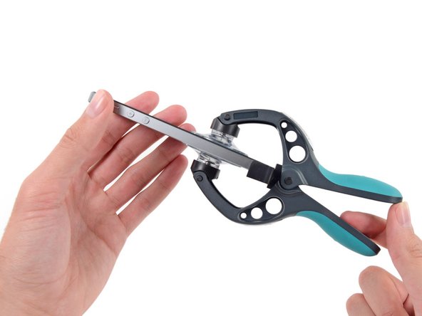

  5. iPhone 5 Front-Facing Camera and Sensor Cable Replacement: step 5, image 1 of 2 iPhone 5 Front-Facing Camera and Sensor Cable Replacement: step 5, image 2 of 2
    • Hold onto your iPhone securely and close the handle of the iSclack to separate the suction cups, pulling the front panel up from the rear case.
    • The iSclack is designed to safely open your iPhone just enough to separate the pieces, but not enough to damage any cables.
    • Peel the two suction cups off your iPhone.
    • Skip the next three steps and continue on [invalid guide link].

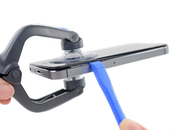

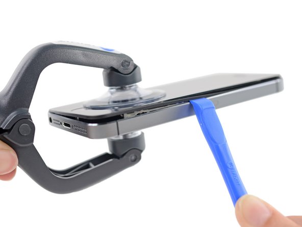

  7. iPhone 5 Front-Facing Camera and Sensor Cable Replacement: step 7, image 1 of 1
    • Make sure the suction cup is firmly attached to the front panel assembly.
    • While holding the iPhone down with one hand, pull up on the suction cup to slightly separate the front panel assembly from the rear case.
    • Take your time and apply firm, constant force. The display assembly is a much tighter fit than most devices.
    • With a plastic opening tool, begin to gently pry the rear case down, away from the display assembly, while you pull up with the suction cup.
    • There are several clips attaching the front panel assembly to the rear case, so you may need to use a combination of the suction cup and plastic opening tool to free the front panel assembly.

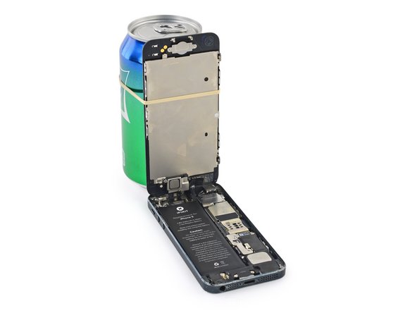

  9. iPhone 5 Front-Facing Camera and Sensor Cable Replacement: step 9, image 1 of 3 iPhone 5 Front-Facing Camera and Sensor Cable Replacement: step 9, image 2 of 3 iPhone 5 Front-Facing Camera and Sensor Cable Replacement: step 9, image 3 of 3
    • Do not try to completely remove the front panel assembly from the rear case, as there are several ribbon cables still attached at the top of the iPhone.
    • Once the clips have been released on the bottom and sides of the front panel assembly, pull the bottom of the assembly away from the rear case.
    • Open the display to about a 90º angle, and lean it against something to keep it propped up while you're working on the phone.
    • Add a rubber band to keep the display securely in place while you work. This prevents undue strain on the display cables.

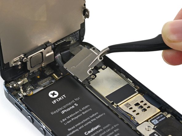

  14. iPhone 5 Front-Facing Camera and Sensor Cable Replacement: step 14, image 1 of 2 iPhone 5 Front-Facing Camera and Sensor Cable Replacement: step 14, image 2 of 2
    • Lift the display cable bracket toward the battery to unhook it, and remove it from the iPhone.
    • During reassembly, clip the left-hand hooks under the logic board and lower the bracket towards the outside of the phone.

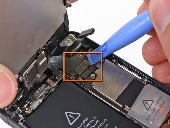

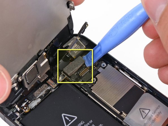

  15. iPhone 5 Front-Facing Camera and Sensor Cable Replacement: step 15, image 1 of 3 iPhone 5 Front-Facing Camera and Sensor Cable Replacement: step 15, image 2 of 3 iPhone 5 Front-Facing Camera and Sensor Cable Replacement: step 15, image 3 of 3
    • Use a plastic opening tool to disconnect the three front panel assembly cables:
    • Front-facing camera and sensor cable
    • LCD cable
    • Digitizer cable
    • When reassembling your phone, the LCD cable may pop off the connector. This can cause white lines, or nothing at all to appear when powering your phone back on. If that happens, simply reconnect the cable and power cycle your phone. The best way to power cycle your phone is to [invalid guide link].

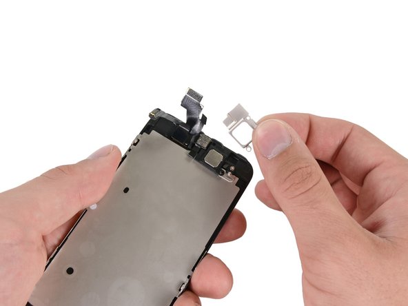

    • Remove the earpiece speaker bracket from the display assembly.
  19. iPhone 5 Front-Facing Camera and Sensor Cable Replacement: step 19, image 1 of 1
    • Remove the earpiece speaker from the iPhone.

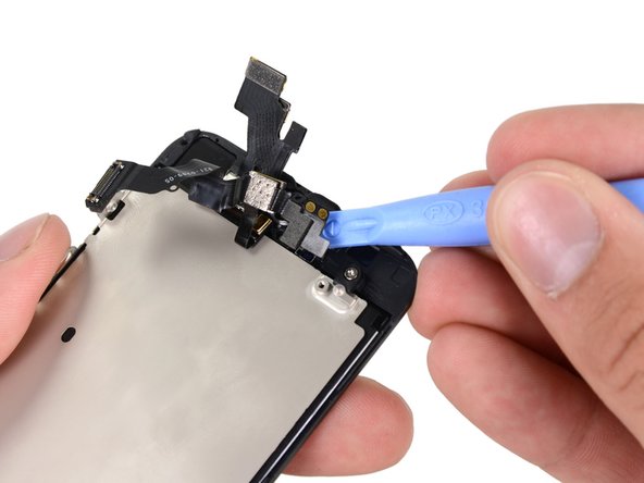

  21. iPhone 5 Front-Facing Camera and Sensor Cable Replacement: step 21, image 1 of 2 iPhone 5 Front-Facing Camera and Sensor Cable Replacement: step 21, image 2 of 2
    • Starting under the earpiece speaker contacts, use a plastic opening tool or the tip of a spudger to pry the front facing camera cable out of the display assembly.
    • Caution: Removing the earpiece speaker contacts can cause them to tear. Use extreme caution when peeling the contacts up.

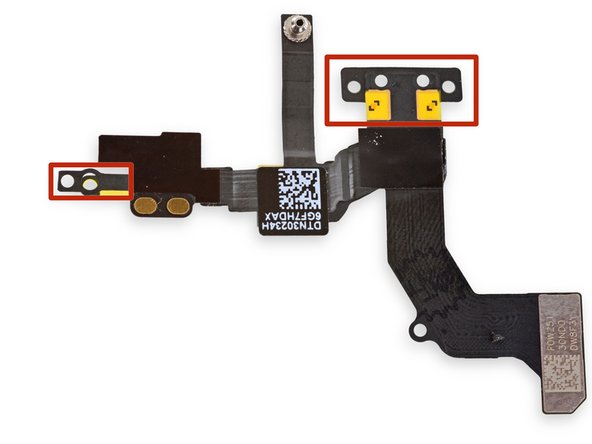

  22. iPhone 5 Front-Facing Camera and Sensor Cable Replacement: step 22, image 1 of 2 iPhone 5 Front-Facing Camera and Sensor Cable Replacement: step 22, image 2 of 2
    • Remove the front-facing camera and rear microphone assembly.
    • If you are installing a new part, your new part may have two tabs with holes in it used for manufacturing purposes. These tabs can be cut off with scissors.
    • There is a small, square plastic and metal holder for the proximity sensor. This holder is essential for the proximity sensor to function correctly.
    • If replacing the proximity sensor or camera make sure that the holder remains adhered to the back of the display. If it comes off with the old proximity sensor, remove it from the old sensor and use a tiny bit of adhesive to re-attach it to the back of the display.
