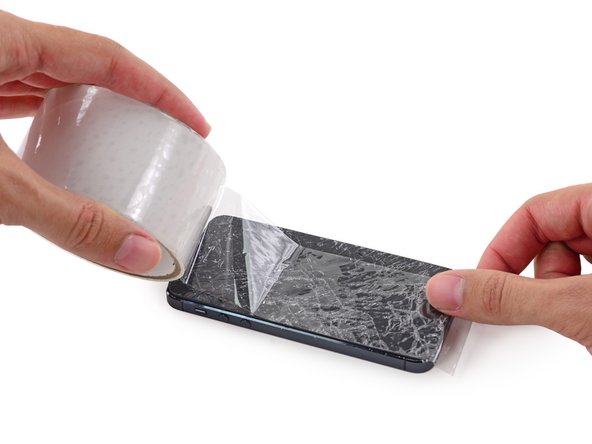

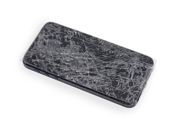

      • If your display glass is cracked, keep further breakage contained and prevent bodily harm during your repair by taping the glass.
      • Lay overlapping strips of clear packing tape over the iPhone's display until the whole face is covered.
      • This will keep glass shards contained and provide structural integrity when prying and lifting the display.
      • Wear safety glasses to protect your eyes from any glass shaken free during the repair.

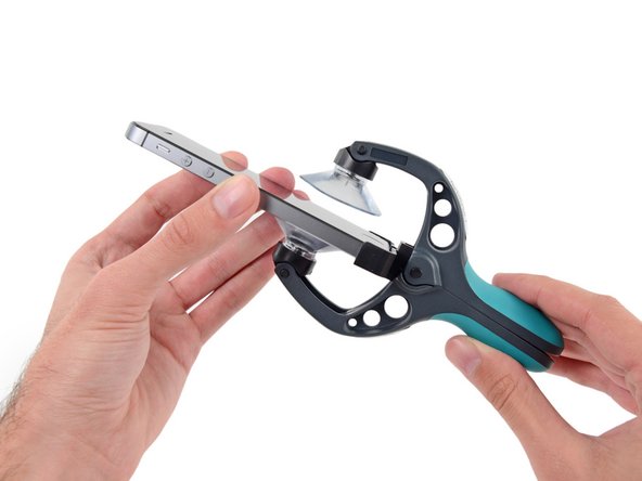

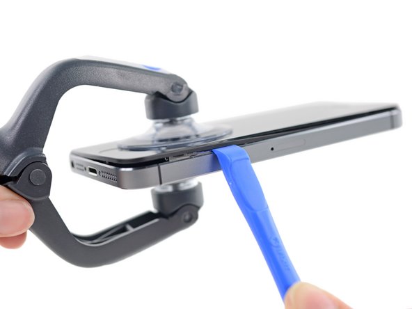

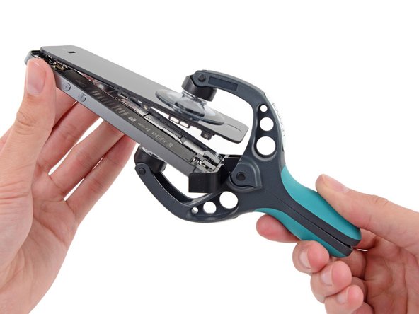

    4. iPhone 5 Power Button Replacement, iSclack Opening Procedure: step 4, image 1 of 3 iPhone 5 Power Button Replacement, iSclack Opening Procedure: step 4, image 2 of 3 iPhone 5 Power Button Replacement, iSclack Opening Procedure: step 4, image 3 of 3
      • The next two steps demonstrate using the , a great tool for safely opening the iPhone 5 that we recommend for anyone doing more than one repair. If you aren't using the iSclack, skip to Step 6.
      • Close the handle on the iSclack, opening the suction-cup jaws.
      • Place the bottom of your iPhone in between the suction cups, against the plastic depth gauge.
      • The top suction cup should rest just above the home button.
      • Open the handles to close the jaws of the iSclack. Center the suction cups and press them firmly onto the top and bottom of the iPhone.

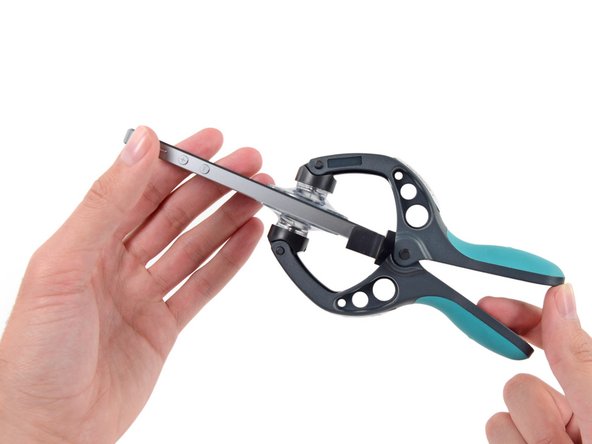

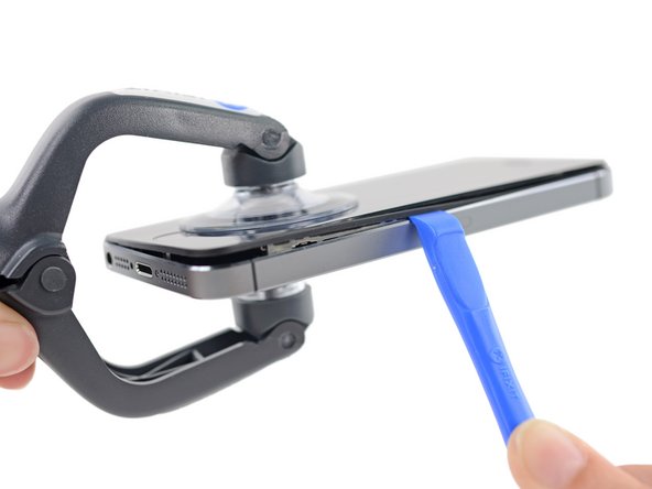

    5. iPhone 5 Power Button Replacement: step 5, image 1 of 2 iPhone 5 Power Button Replacement: step 5, image 2 of 2
      • Hold onto your iPhone securely and close the handle of the iSclack to separate the suction cups, pulling the front panel up from the rear case.
      • The iSclack is designed to safely open your iPhone just enough to separate the pieces, but not enough to damage any cables.
      • Peel the two suction cups off your iPhone.

      • While holding the iPhone down with one hand, pull up on the suction cup to slightly separate the front panel assembly from the rear case.
      • Take your time and apply firm, constant force. The display assembly is a much tighter fit than most devices.
      • With a plastic opening tool, begin to gently pry the rear case down, away from the display assembly, while you pull up with the suction cup.
      • There are several clips attaching the front panel assembly to the rear case, so you may need to use a combination of the suction cup and plastic opening tool to free the front panel assembly.

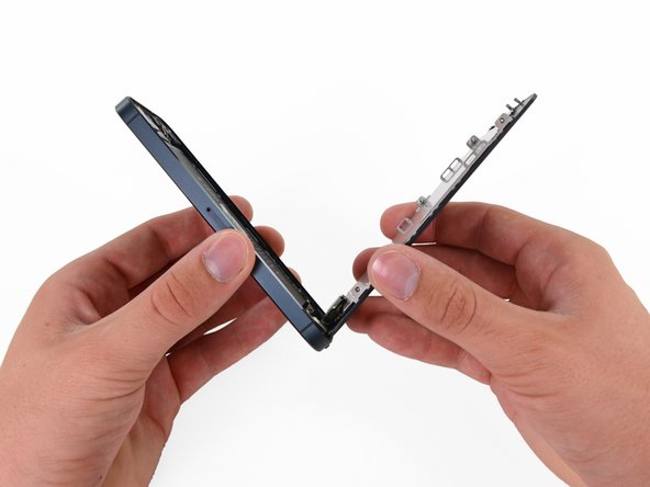

    9. iPhone 5 Power Button Replacement: step 9, image 1 of 3 iPhone 5 Power Button Replacement: step 9, image 2 of 3 iPhone 5 Power Button Replacement: step 9, image 3 of 3

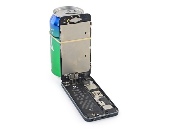

      • Do not try to completely remove the front panel assembly from the rear case, as there are several ribbon cables still attached at the top of the iPhone.
      • Once the clips have been released on the bottom and sides of the front panel assembly, pull the bottom of the assembly away from the rear case.
      • Open the display to about a 90º angle, and lean it against something to keep it propped up while you're working on the phone.
      • Add a rubber band to keep the display securely in place while you work. This prevents undue strain on the display cables.

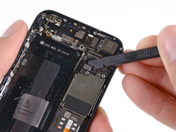

      • Use a plastic opening tool to gently pry the battery connector up from its socket on the logic board.
      • Be very careful to only pry up on the battery connector and not the socket on the logic board. If you pry up on the logic board socket, you may break the connector entirely.

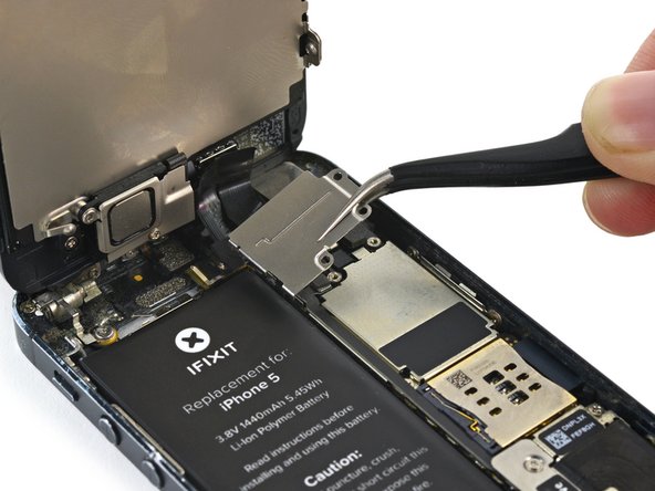

    14. iPhone 5 Power Button Replacement: step 14, image 1 of 2 iPhone 5 Power Button Replacement: step 14, image 2 of 2
      • Lift the display cable bracket toward the battery to unhook it, and remove it from the iPhone.
      • During reassembly, clip the left-hand hooks under the logic board and lower the bracket towards the outside of the phone.

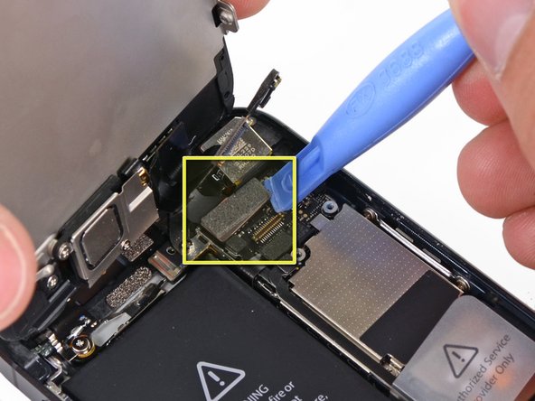

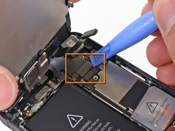

      • Use a plastic opening tool to disconnect the three front panel assembly cables:
      • Front-facing camera and sensor cable
      • LCD cable
      • Digitizer cable
      • When reassembling your phone, the LCD cable may pop off the connector. This can cause white lines, or nothing at all to appear when powering your phone back on. If that happens, simply reconnect the cable and power cycle your phone. The best way to power cycle your phone is to disconnect and reconnect the battery.

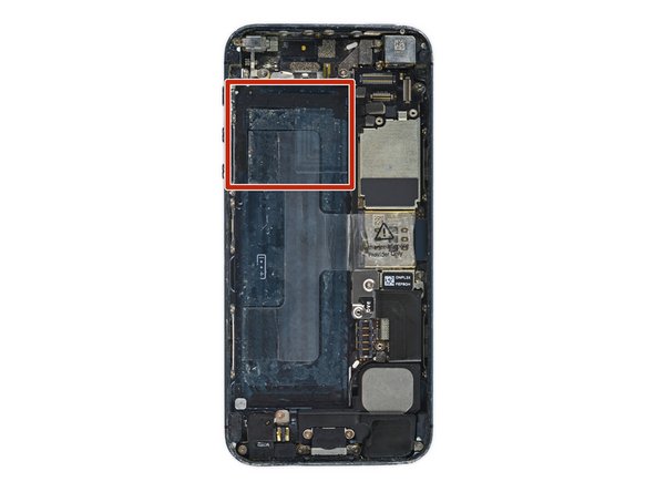

      • Use the exposed clear plastic pull tab to peel the battery off the adhesive securing it to the iPhone.
      • If you have trouble peeling the battery up, use an iOpener or hair dryer to heat the rear case of the iPhone and soften the adhesive.
      • The plastic tab is fragile and may break. If your tab breaks before the battery is freed, refer to the following steps.
    18. iPhone 5 Power Button Replacement: step 18, image 1 of 1
      • If the tab breaks off and the battery remains stuck to the rear case, prepare an iOpener or use a hair dryer to heat the rear case directly behind the battery.
      • This will soften the adhesive holding the battery, making it easier and safer to pry out of the case.
    19. iPhone 5 Power Button Replacement: step 19, image 1 of 2 iPhone 5 Power Button Replacement: step 19, image 2 of 2
      • Use the plastic opening tool to gently pry the battery up, only at the outside edge of the phone. Prying anywhere else, especially near the logic board, may result in damage to the logic board.
      • If the battery doesn't pry easily out of the case, reheat and reapply the iOpener and try again.
      • Pry gently and evenly to avoid deforming the battery. A bent battery can be a fire hazard.
      • Do not pry at the top portion of the battery, you risk severing the volume control cables.

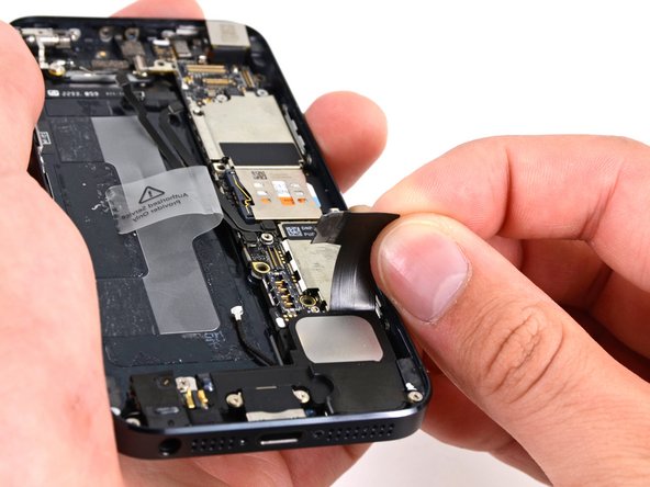

      • Use a spudger to pry the Lightning connector cable connector up from its socket on the logic board.
      • Gently peel the cable back and out of the way of the logic board.

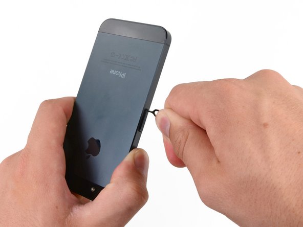

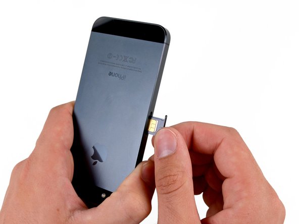

    29. iPhone 5 Power Button Replacement: step 29, image 1 of 3 iPhone 5 Power Button Replacement: step 29, image 2 of 3 iPhone 5 Power Button Replacement: step 29, image 3 of 3
      • Depress the SIM card release on the right side of the iPhone with a SIM card eject tool or a bent paperclip to eject the SIM card tray.
      • Alternatively, you can press the SIM card eject lever from the inside with the flat end of a spudger.
      • Remove the SIM card tray from the iPhone.

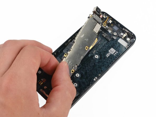

    31. iPhone 5 Power Button Replacement: step 31, image 1 of 3 iPhone 5 Power Button Replacement: step 31, image 2 of 3 iPhone 5 Power Button Replacement: step 31, image 3 of 3
      • Rotate the logic board assembly toward the battery side of the rear case.
      • Do not attempt to completely remove the logic board assembly from the rear case, yet; there is still one cable connected to the underside of the logic board.
      • The flash surround is adhered to the flash unit and the rear case. If it stays on the rear case remove with tweezers and mount it back on the flash unit.
      • Note: when reassembling your device, be sure that the lower interconnect cable is not tucked underneath the logic board.

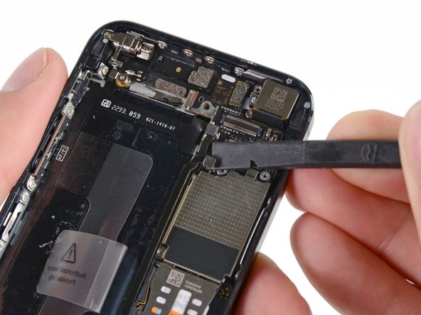

      • Use the tip of a spudger to pry the Wi-Fi antenna cable connector up from its socket on the underside of the logic board.

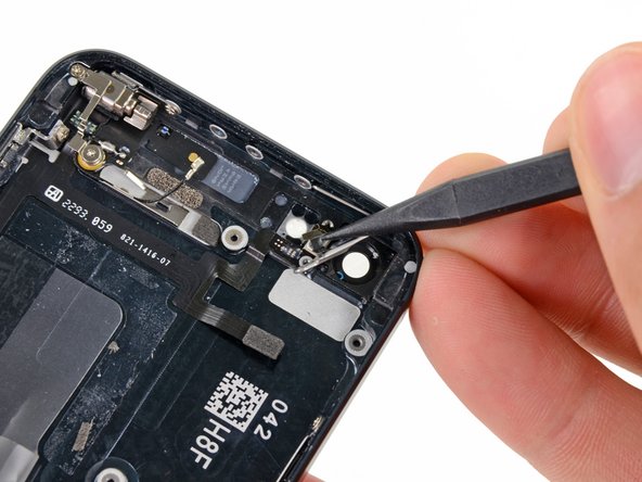

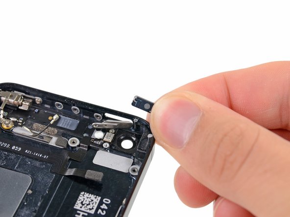

      • Use the tip of a spudger to remove the rubber bumper from below the power button.

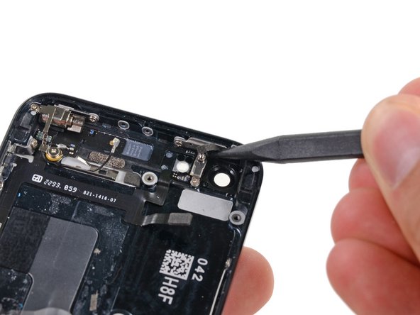

    35. iPhone 5 Power Button Replacement: step 35, image 1 of 2 iPhone 5 Power Button Replacement: step 35, image 2 of 2

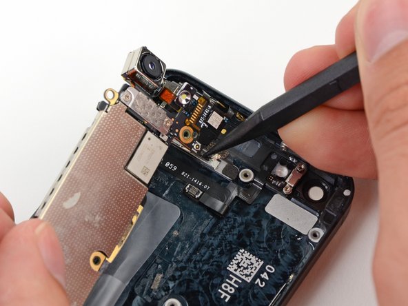

      • Remove the following screws from the metal bracket between the rear facing flash and camera windows:
      • One 2.9 mm standoff screw
      • This screw has a Phillips bit pattern, but we found the best removal tool to use is a 2.5 mm flathead driver.
      • One 1.6 mm Phillips screw
      • One 1.9 mm Phillips screw

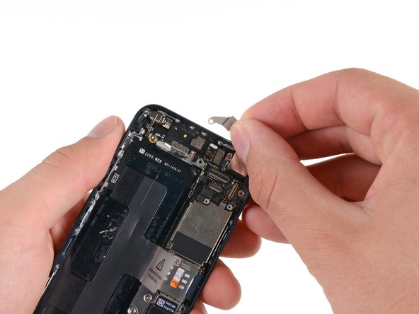

    36. iPhone 5 Power Button Replacement: step 36, image 1 of 1
      • Remove the metal bracket between the rear facing flash and camera windows.

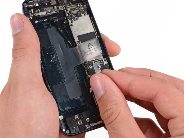

    37. iPhone 5 Power Button Replacement: step 37, image 1 of 2 iPhone 5 Power Button Replacement: step 37, image 2 of 2

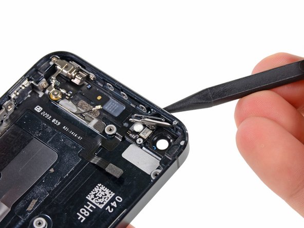

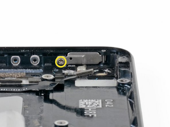

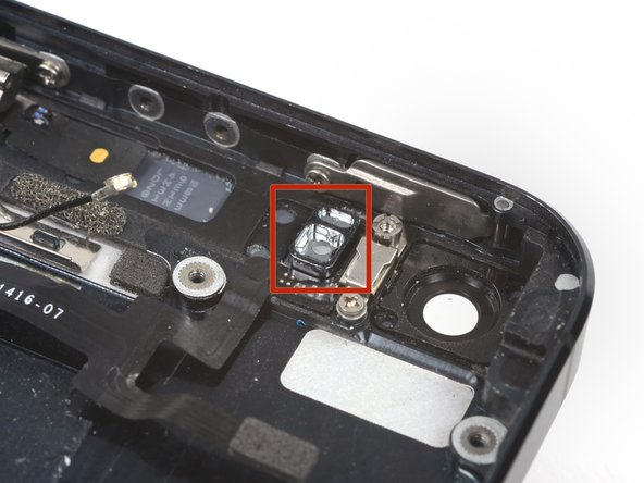

      • Use the tip of a spudger to flip the metal bracket holding the power switch away from the top of the rear case.
    38. iPhone 5 Power Button Replacement: step 38, image 1 of 3 iPhone 5 Power Button Replacement: step 38, image 2 of 3 iPhone 5 Power Button Replacement: step 38, image 3 of 3
      • Press the power button into the rear case from the outside of the phone with the tip of a spudger.
      • Remove the power button.
