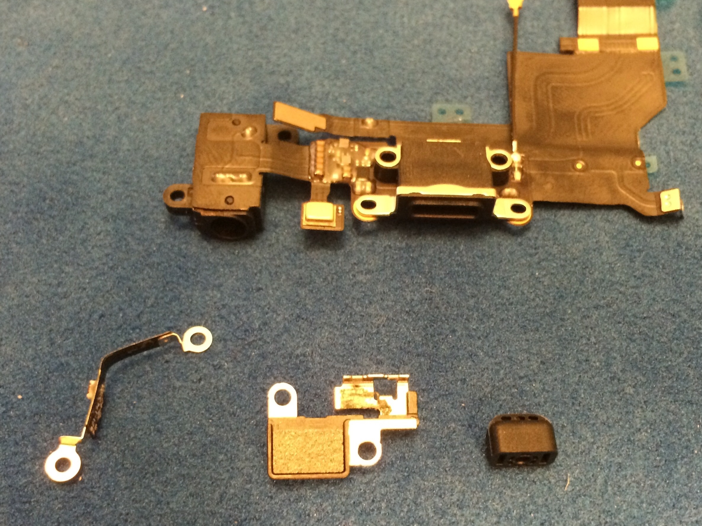

    • Use a plastic opening tool to lift the logic board up enough to grab with your fingers.
  32. iPhone 5s Lightning Connector Replacement: step 32, image 1 of 3 iPhone 5s Lightning Connector Replacement: step 32, image 2 of 3 iPhone 5s Lightning Connector Replacement: step 32, image 3 of 3
    • Pull the logic board slightly away from the rear facing camera.
    • Do not try to remove the logic board just yet, as it is still connected by an antenna cable on the back.
    • Flip the logic board toward the battery, as if you are turning the page in a book.
  33. iPhone 5s Lightning Connector Replacement: step 33, image 1 of 2 iPhone 5s Lightning Connector Replacement: step 33, image 2 of 2
    • Use the flat end of a spudger to disconnect the antenna cable on the back of the logic board.
    • Remove the logic board from the iPhone.
  34. iPhone 5s Lightning Connector Replacement: step 34, image 1 of 3 iPhone 5s Lightning Connector Replacement: step 34, image 2 of 3 iPhone 5s Lightning Connector Replacement: step 34, image 3 of 3
    • At this point, a small metal plate near the rear facing camera is loose and may come free from its recess.
    • Because it is very small and easy to lose, it's best to remove this plate and set it aside while you continue to work on your phone.
    • Use tweezers to remove the plate from beneath the bracket to the left of the rear-facing camera.
    • When reassembling, orient the plate with the small tab to the right and the longest flat edge against the top of the phone.

  41. iPhone 5s Lightning Connector Replacement: step 41, image 1 of 1
    • Remove the Lightning connector assembly.
    • Examine your replacement part, and your original cable carefully to be sure they match. Your replacement new Lightning connector assembly may be missing certain components that need to be transferred from the original.
    • Components that commonly need to be transferred include a clip routed along the left and top edges of the headphone jack, the bracket for the Touch ID cable connector, and the rubber microphone cover.
  42. iPhone 5s Lightning Connector Replacement: step 42, image 1 of 2 iPhone 5s Lightning Connector Replacement: step 42, image 2 of 2
    • There are two small metal pieces—a bracket and a washer—that may come loose or fall out of the phone with the Lightning connector assembly removed.
    • If you are removing more components, take these pieces out and set them aside for safe keeping.
