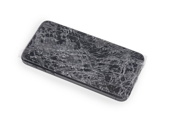

  1. iPhone 5s Logic Board Replacement, Logic Board: step 1, image 1 of 3 iPhone 5s Logic Board Replacement, Logic Board: step 1, image 2 of 3 iPhone 5s Logic Board Replacement, Logic Board: step 1, image 3 of 3

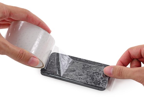

    • If your display glass is cracked, keep further breakage contained and prevent bodily harm during your repair by taping the glass.
    • Lay overlapping strips of clear packing tape over the iPhone's display until the whole face is covered.
    • This will keep glass shards contained and provide structural integrity when prying and lifting the display.
    • Wear safety glasses to protect your eyes from any glass shaken free during the repair.

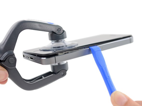

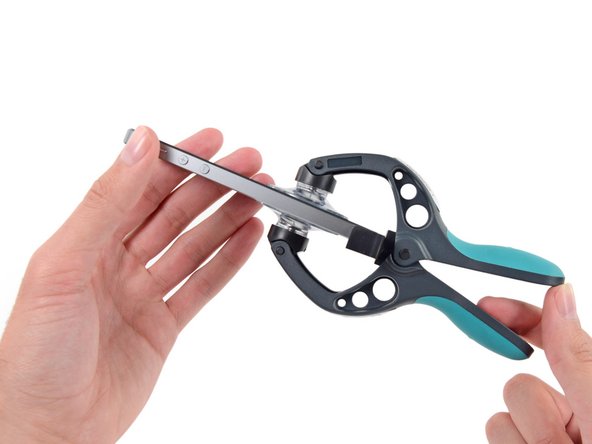

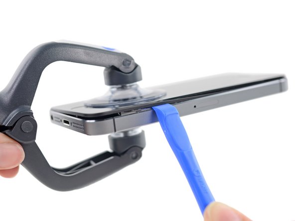

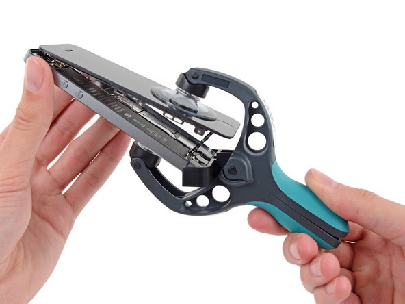

  4. iPhone 5s Logic Board Replacement, iSclack Opening Procedure: step 4, image 1 of 3 iPhone 5s Logic Board Replacement, iSclack Opening Procedure: step 4, image 2 of 3 iPhone 5s Logic Board Replacement, iSclack Opening Procedure: step 4, image 3 of 3
    • The next two steps demonstrate using the , a great tool for safely opening the iPhone 5s that we recommend for anyone doing more than one repair. If you aren't using the iSclack, skip to [invalid guide link].
    • Close the handle on the iSclack, opening the suction-cup jaws.
    • Place the bottom of your iPhone in between the suction cups, against the plastic depth gauge.
    • The top suction cup should rest just above the home button.
    • Open the handles to close the jaws of the iSclack. Center the suction cups and press them firmly onto the top and bottom of the iPhone.
  5. iPhone 5s Logic Board Replacement: step 5, image 1 of 2 iPhone 5s Logic Board Replacement: step 5, image 2 of 2
    • Hold onto your iPhone securely and close the handle of the iSclack to separate the suction cups, pulling the front panel up from the rear case.
    • The iSclack is designed to safely open your iPhone just enough to separate the pieces, but not enough to damage the home button cable.
    • Peel the two suction cups off your iPhone.
    • Skip the next three steps and continue on Step 9.

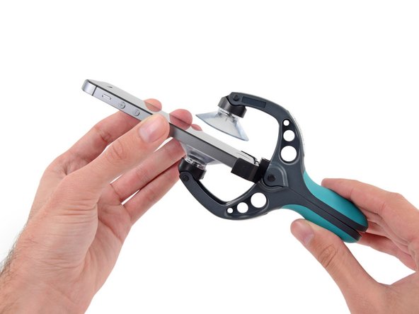

  6. iPhone 5s Logic Board Replacement, Manual Opening Procedure: step 6, image 1 of 1

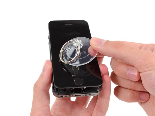

    • If you don't have an iSclack, use a single suction cup to lift the front panel:
    • Press a suction cup onto the screen, just above the home button.
    • Be sure the cup is completely on the screen to get a tight seal.
  7. iPhone 5s Logic Board Replacement: step 7, image 1 of 1
    • The front panel is attached with clips, and there are several ribbon cables connecting it to the rest of the phone. Your goal here is to release the clips and open the phone only enough to disconnect the cables. Go slowly and carefully to avoid damage.
    • Make sure the suction cup is firmly attached to the front panel assembly near the home button.
    • While holding the iPhone down with one hand, pull up on the suction cup to slightly separate the home button end of the front panel from the rear case.
    • With a plastic opening tool, gently pry the edges of the rear case down, away from the front panel assembly, while you pull up with the suction cup.
    • Take your time and apply firm, constant force. The 5s front panel assembly is a much tighter fit than most devices.

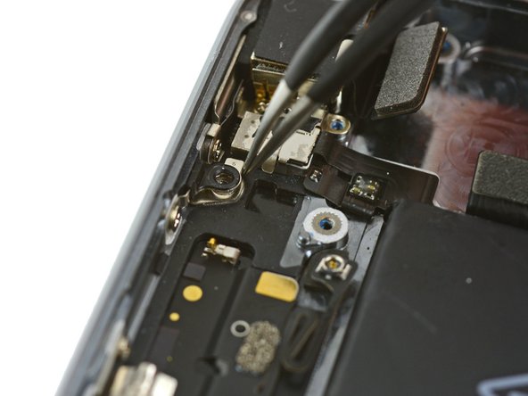

  9. iPhone 5s Logic Board Replacement: step 9, image 1 of 3 iPhone 5s Logic Board Replacement: step 9, image 2 of 3 iPhone 5s Logic Board Replacement: step 9, image 3 of 3
    • Open the phone just enough to reveal the metal bracket covering the home button cable.
    • Do not open the phone too far or you risk damaging the home button cable, or the socket it plugs into. Keep the cable loose—if it is stretched taut, that's too far.
    • Only the phone's original home button assembly will be capable of using the Touch ID functionality. If you rip the cable, installing a new home button will only restore ordinary home button functions, not the Touch ID features.
    • Use the tip of a spudger to push the bracket free and remove it with tweezers.
    • The next two steps apply to reassembly. Skip them and continue to Step 12 until reassembly.

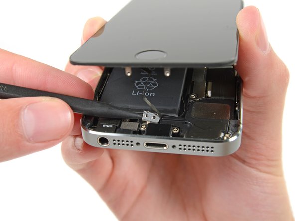

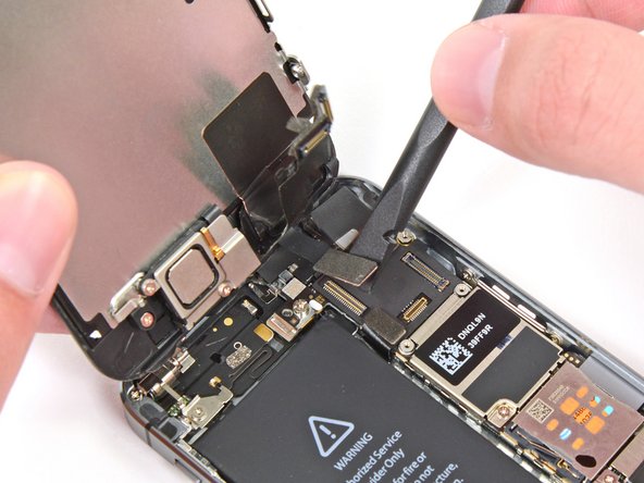

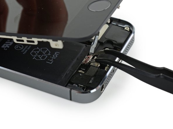

  12. iPhone 5s Logic Board Replacement: step 12, image 1 of 2 iPhone 5s Logic Board Replacement: step 12, image 2 of 2
    • Use the tip of a spudger to pry the home button cable connector up out of its socket.
    • Be sure you're separating the cable connector from its socket, and not prying the entire socket up. The socket is on its own glued-down cable that can be pried up if you aren't careful.

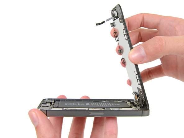

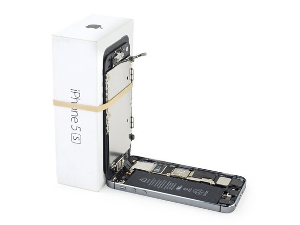

  13. iPhone 5s Logic Board Replacement: step 13, image 1 of 3 iPhone 5s Logic Board Replacement: step 13, image 2 of 3 iPhone 5s Logic Board Replacement: step 13, image 3 of 3
    • Once the connector has been released, pull the home button end of the assembly away from the rear case, using the top of the phone as a hinge.
    • Open the display to about a 90º angle, and lean it against something to keep it propped up while you're working on the phone.
    • Add a rubber band to keep the display securely in place while you work. This prevents undue strain on the display cables.
    • In a pinch, you can use an unopened canned beverage to hold the display.

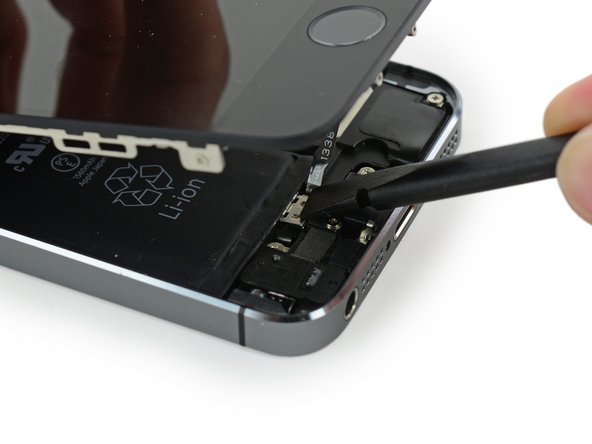

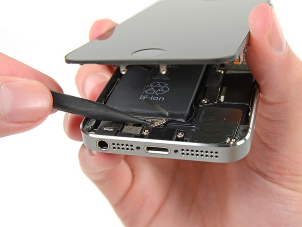

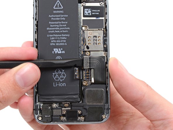

  16. iPhone 5s Logic Board Replacement: step 16, image 1 of 2 iPhone 5s Logic Board Replacement: step 16, image 2 of 2
    • Use the flat end of a spudger to gently pry the battery connector up from its socket on the logic board.
    • Be very careful to only pry up on the battery connector itself and not the socket on the logic board. If you pry up on the logic board socket, you may break the connector entirely.

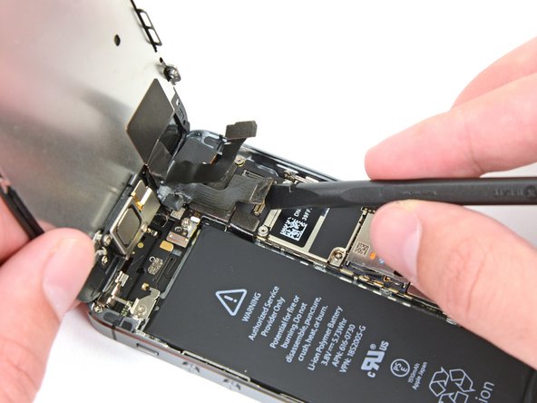

  19. iPhone 5s Logic Board Replacement: step 19, image 1 of 2 iPhone 5s Logic Board Replacement: step 19, image 2 of 2

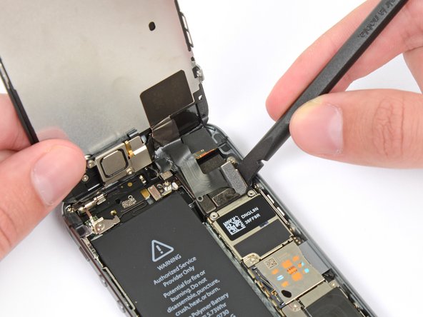

    • Use the flat end of a spudger to disconnect the front-facing camera and sensor cable.
  20. iPhone 5s Logic Board Replacement: step 20, image 1 of 2 iPhone 5s Logic Board Replacement: step 20, image 2 of 2
    • While still supporting the front panel, disconnect the LCD cable connector.
    • When reassembling your phone, the LCD cable may pop off the connector. This can result in white lines or a blank screen when powering your phone back on. If that happens, simply reconnect the cable and power cycle your phone. The best way to power cycle your phone is to disconnect and reconnect the battery.

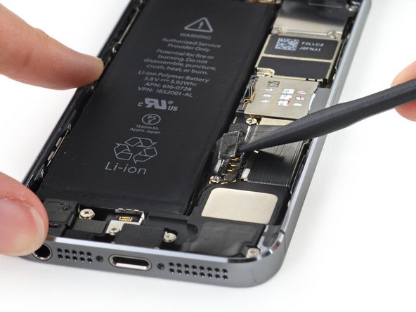

  21. iPhone 5s Logic Board Replacement: step 21, image 1 of 2 iPhone 5s Logic Board Replacement: step 21, image 2 of 2
    • Finally, disconnect the digitizer cable connector.

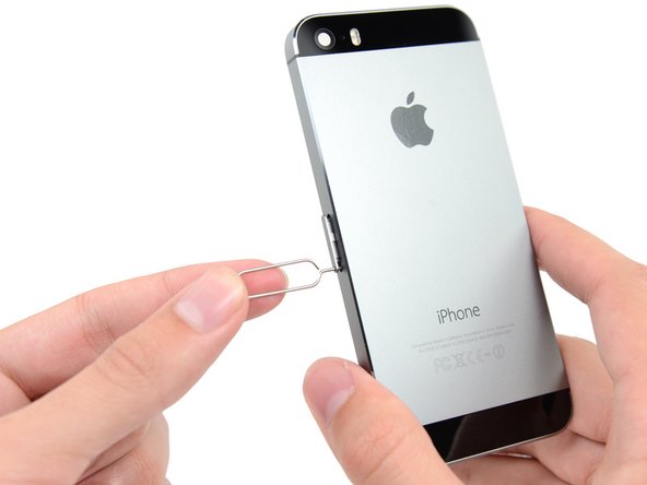

  23. iPhone 5s Logic Board Replacement: step 23, image 1 of 2 iPhone 5s Logic Board Replacement: step 23, image 2 of 2
    • Insert a SIM card eject tool or a paperclip into the small hole in the SIM card tray.
    • Press to eject the tray. This may require a significant amount of force.
  24. iPhone 5s Logic Board Replacement: step 24, image 1 of 1
    • Remove the SIM Card tray assembly from the iPhone.
    • When reinserting the SIM card, ensure that it is in the proper orientation relative to the tray.

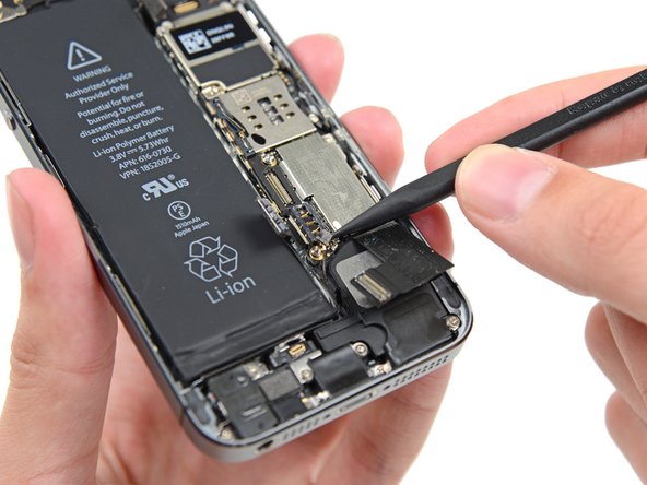

    • Use a spudger to gently pry the button assembly cable up from its socket on the logic board.
    • Be very careful to only pry up on the connector and not the socket on the logic board. If you pry up on the logic board socket, you may break the connector entirely.

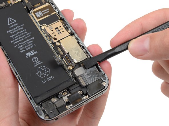

  26. iPhone 5s Logic Board Replacement: step 26, image 1 of 3 iPhone 5s Logic Board Replacement: step 26, image 2 of 3 iPhone 5s Logic Board Replacement: step 26, image 3 of 3
    • Use a spudger to pry the Lightning connector cable up from its socket on the logic board.
    • Fold the Lightning connector cable out of the way of the logic board.

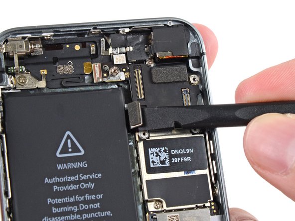

  27. iPhone 5s Logic Board Replacement: step 27, image 1 of 2 iPhone 5s Logic Board Replacement: step 27, image 2 of 2

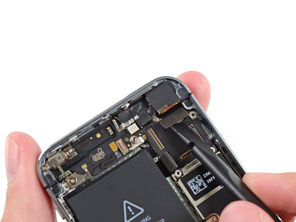

    • Use the tip of a spudger to pry the antenna cable up from its socket on the logic board.
  28. iPhone 5s Logic Board Replacement: step 28, image 1 of 2 iPhone 5s Logic Board Replacement: step 28, image 2 of 2
    • Use the flat end of a spudger to disconnect the rear-facing camera cable from its socket on the logic board.

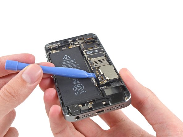

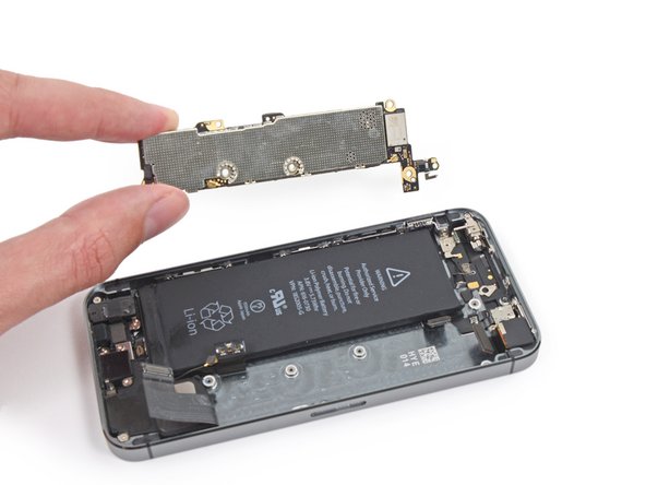

  31. iPhone 5s Logic Board Replacement: step 31, image 1 of 2 iPhone 5s Logic Board Replacement: step 31, image 2 of 2

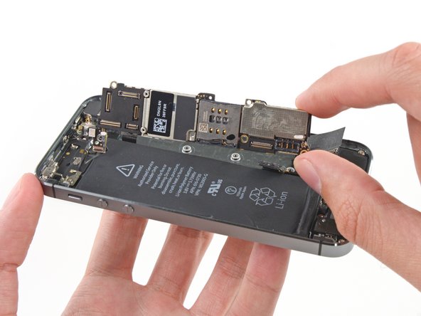

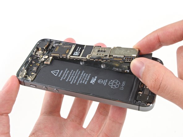

    • Use a plastic opening tool to lift the logic board up enough to grab with your fingers.
  32. iPhone 5s Logic Board Replacement: step 32, image 1 of 3 iPhone 5s Logic Board Replacement: step 32, image 2 of 3 iPhone 5s Logic Board Replacement: step 32, image 3 of 3
    • Pull the logic board slightly away from the rear facing camera.
    • Do not try to remove the logic board just yet, as it is still connected by an antenna cable on the back.
    • Flip the logic board toward the battery, as if you are turning the page in a book.
  33. iPhone 5s Logic Board Replacement: step 33, image 1 of 2 iPhone 5s Logic Board Replacement: step 33, image 2 of 2
    • Use the flat end of a spudger to disconnect the antenna cable on the back of the logic board.
    • Remove the logic board from the iPhone.

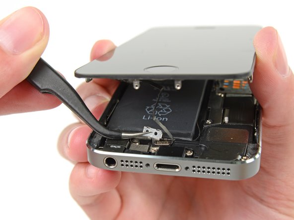

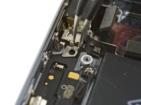

  34. iPhone 5s Logic Board Replacement: step 34, image 1 of 3 iPhone 5s Logic Board Replacement: step 34, image 2 of 3 iPhone 5s Logic Board Replacement: step 34, image 3 of 3
    • At this point, a small metal plate near the rear facing camera is loose and may come free from its recess.
    • Because it is very small and easy to lose, it's best to remove this plate and set it aside while you continue to work on your phone.
    • Use tweezers to remove the plate from beneath the bracket to the left of the rear-facing camera.
    • When reassembling, orient the plate with the small tab to the right and the longest flat edge against the top of the phone.
